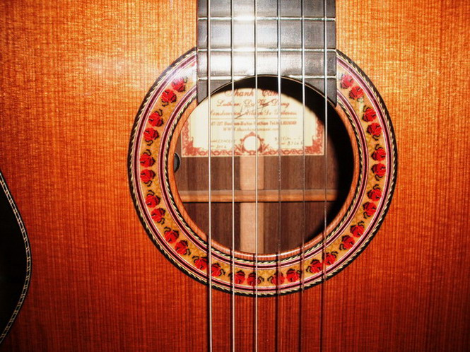

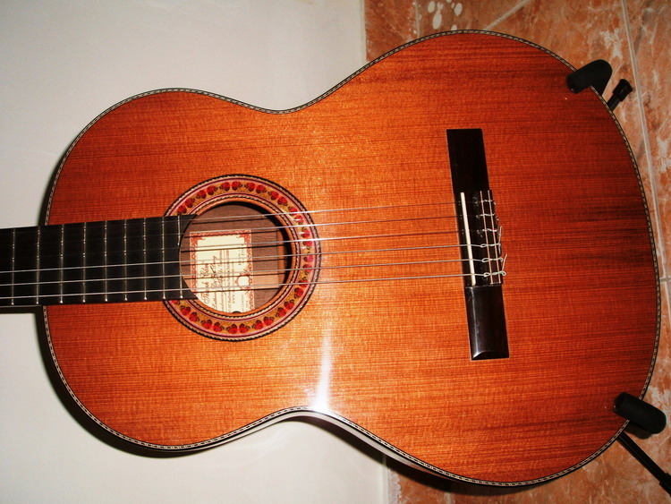

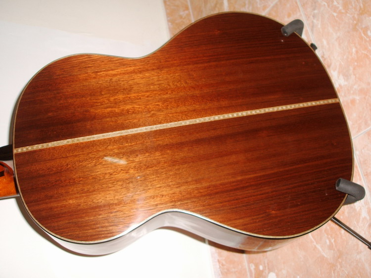

Here are some pictures of a redwood top with Peruvian walnut sides and back, mahogany neck, Macassar Ebony fretboard and ebony bridge.   You can tell the density of the grain from the rosette photo. The soundhole is 3 7/16". It has high tension Savarez cristal strings.
It is the first classical I have ever owned so I can not compare. I have never really liked the flat wide necks of classicals but I find myself picking this one up the most when learning new songs. I mostly fingerpick chords. I like it because it is small and lightweight. the strings are well balanced in volume from the treble to the bass. It sounds closer to a human voice than my steel string guitars.

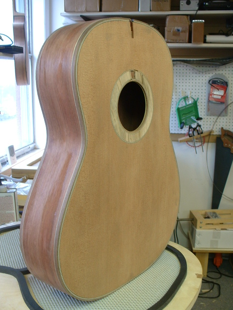

Go for it, Peter. Redwood makes beautiful sounding , and looking, classicals. Here's one almost ready for FP:
Bubinga back/ribs; black walnut binding. The rosette is spalted maple from a downed tree on my client's family farm.
